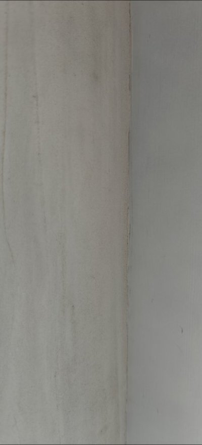

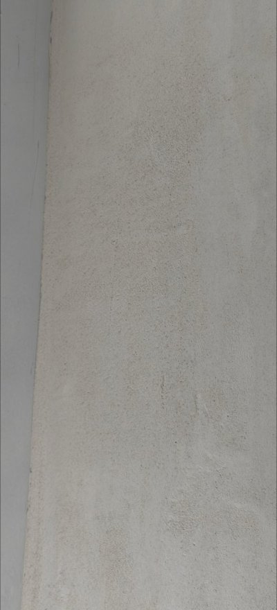

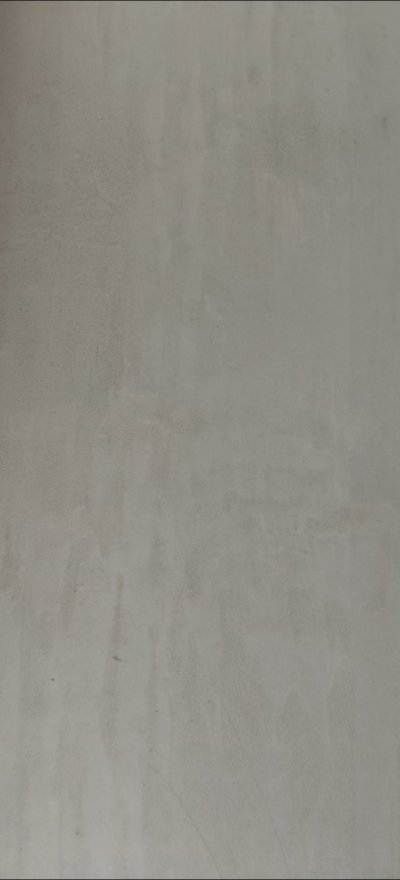

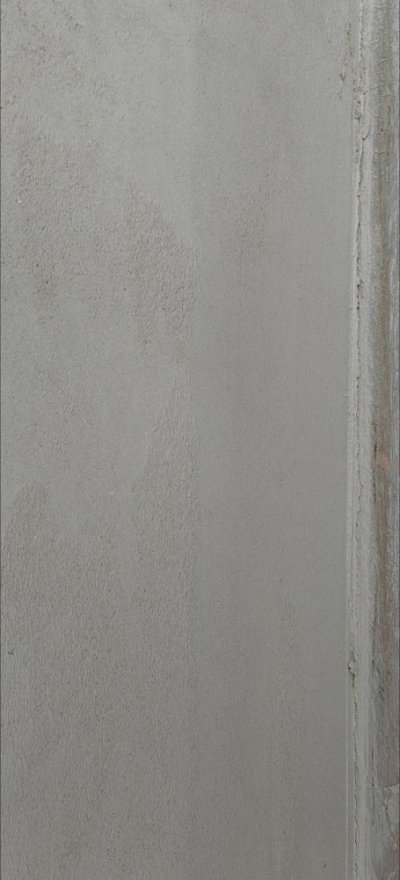

We have been using iQ-Therm for few years on a couple of old properties. First the 1.0 system that used the larger boards (much preferred to newer ones) and on our latest project we have to use the new iQ therm 2.0 as the old stuff is all gone. Both systems are v.expensive. Our latest home requires a lot more m2 of external stone walls than we can afford to insulate using iQ-Therm.
To cut costs we have ditched all the Remmers glues and plaster and just use NHL3.5/playsand mix to stick the boards to the wall along with some plastic fixings to be sure. We are plastering on it with NHL2/sand mix imbedded with plastic mesh and skimming with NHL2/playsand mix. Our first walls were finished using this system over 6 months ago and came up great.
