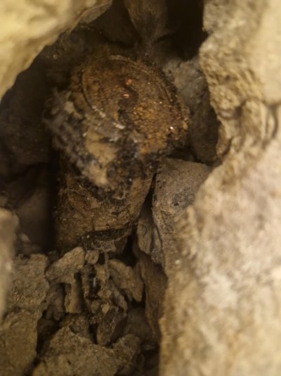

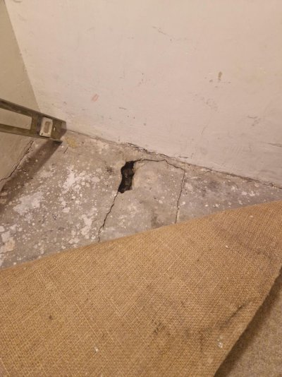

Thanks. No there isn't. It looks like wood and feels like wood but now Im wondering its something like a pipe. I don't wish to touch it too much.Are there any trees or substantial bushes growing within 50feet/15metres of any external wall of the house?
It's around 1905. It looks like bark on the outside but perhaps it just so old and rotten. Could it be an electrical supply? I gather in 1905 they would have gone electric.More than likely. How old is the house?
It's around 3cmWhat diameter is it?

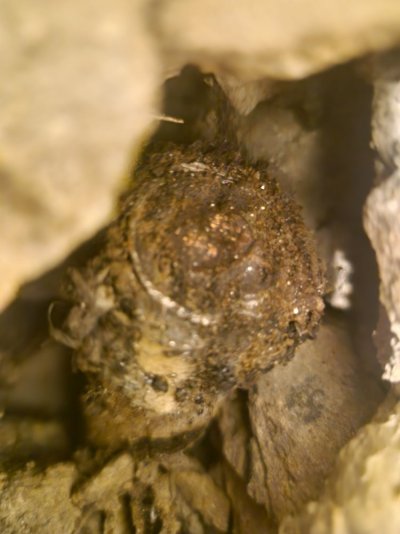

Someone has suggested its the original PILC cable??Then highly unlikely to be an electricity cable/wire. The cable used for the primary supply to a house would be no more that 15mm maybe 20 at the outside. I would rub the exposed end with a wooden stick to see if doing so reveals an inner twisted wire core. If it appears to be solid and silver like in colour it may well be the remains of an old water or even gas feed that was a cut and sealed at some time in the past. I would be tempted to fix a plastic cap of some kind and bury the exposed end in some mortar.
Likely to be the original electricity supply cable. What looks like a lead sheath doesn't look thick enough for a water or gas supply. Sheaths/insulation could be waxed cotton, lead, pitch and/or rubber (that's long perished) - all sorts of possibilities in a cable of that age. Supply voltages varied by supplier in the early days, with DC supply being fairly common, and a heavy cable (with lots of not very effective insulation) might have been thought necessary.
When you suggested a PILC (Paper Insulated Lead Covered) cable I did a little checking. At 30mm+ in diameter, such a cable would have been capable of carrying voltages significantly in excess of those needed to power a domestic residence. Also, being encased in a lead sheath with an outer wrapping of oiled paper the inner cables would not be detectable by most Metal Detectors. In addition the current carrying inner cores were typically copper or aluminium. Looking closely at the latest photo I can see what I think is the ends of copper wires which would confirm its purpose.
If you have access to a Multimeter or a Contact Voltage device it's easy enough to determine if the cable is carrying a current. Frankly, given it seems to have been cut some time ago and buried beneath your floor that's unlikely but if in doubt call your electricity supplier.
