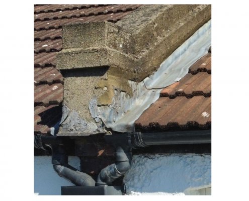

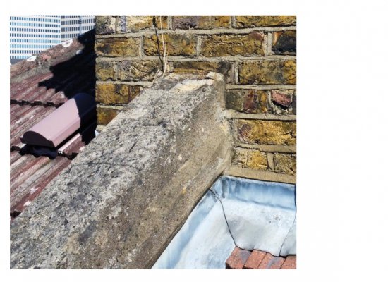

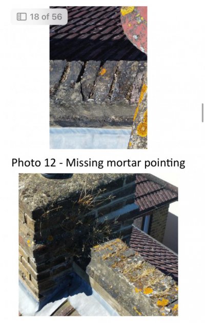

1. The parapet (also surveyed using a drone):
Is badly weathered as there is no capping, which is needed front and back - there is also a lot of plant growth along it too.
The lead flashing is very worn and needs replacement - they are leaking (there is penetrating damp in the bedroom below)
The surveyor couldn't quite see the Soakers and believes due to the penetration damp, will likely need replacing.
There is quite a bit of cracking to the render to the parapet walls - it needs filling in the short term.
I am quite concerned with the above because there is obviously a leak.
2. Flashing around chimney stacks (x3) need replacing, plus, quite a lot of repointing needed too. Surveyor says there is risk and likelihood of penetration damp.
