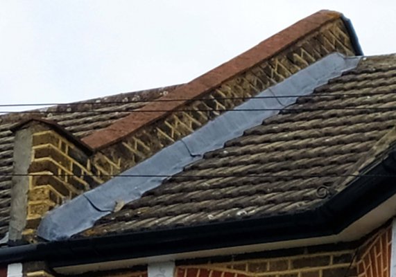

I've been getting damp smells from the party wall under this parapet after it rains for the past year or so.

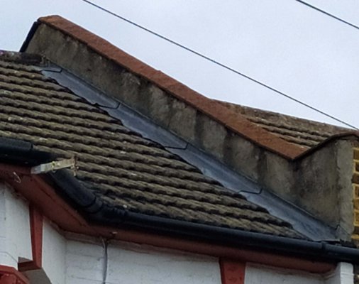

Most of the weather hits my neighbours' rendered side rather than mine. The dark patches / streaks on my neighbours' side suggest to me that quite a bit of water comes through the joints between the coping stones and that there may be a more extensive problem in the top half of their side of the parapet where the render is all dark coloured - potentially from a gap at the peak of the coping letting water behind the render?
What do you think?
