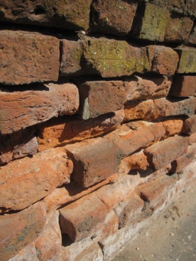

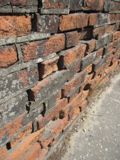

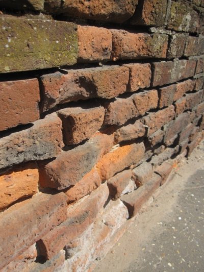

I walk past these garden walls in the village and every time I think I should share them as a warning to anyone with lime mortar and soft bricks not to let cement near them - at least these are just garden walls not the houses.
The walls are next to a B road with a tarmac pavement but no direct drainage so they get splashed with a lot of water during the winter.
You can see how the water has got in behind the mortar and destroyed the bricks leaving a spiders web of the cement repointing that gradually falls out
The same damage has been done to the walls of several gardens but another similar wall a couple of doors further up is in good nick - presumably because they used the right materials - its hard to tell under the moss and road grime.
