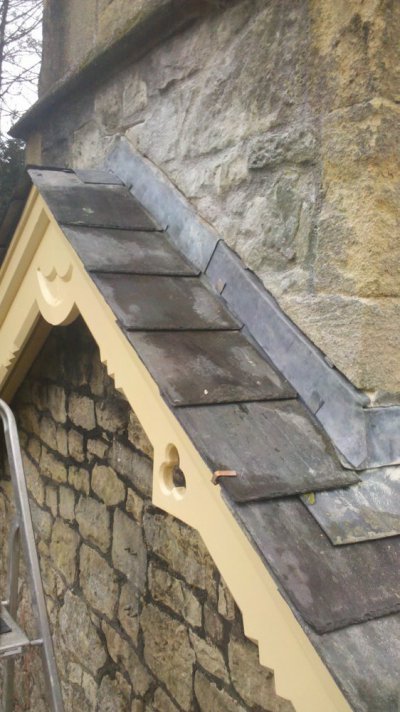

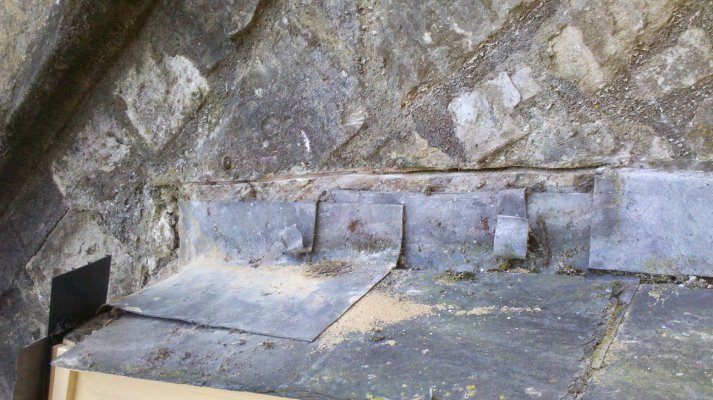

I've got some repair work to do soon on a single storey roof that abuts a gable end wall. The leadwork was pretty shoddy before and needs replacing with proper lead soakers and flashing. As such, a couple or rows of slates will be coming off.
I've heard it's best to use slate and a halfs where possible, rather than thin width sections of slates. But upon enquiring it seems you don't really get slate and a halves in reclaimed Welsh slates. So that leaves me two options...
1. Forget about slate and a halves, use thinner width slates as needed, and carry on.
2. Use larger format but thicker slates. One rec yard has 30" x 20" slates which could be cut down to almost slate and a half (24" x 20"). The existing slates are 24"x 14". The trouble is that these slates are quite thick compared to the existing. I've never done and am no expert on roofing so am not sure whether the slates being thicker would cause more problems than I'm trying to solve?!
Any thoughts gratefully received!
