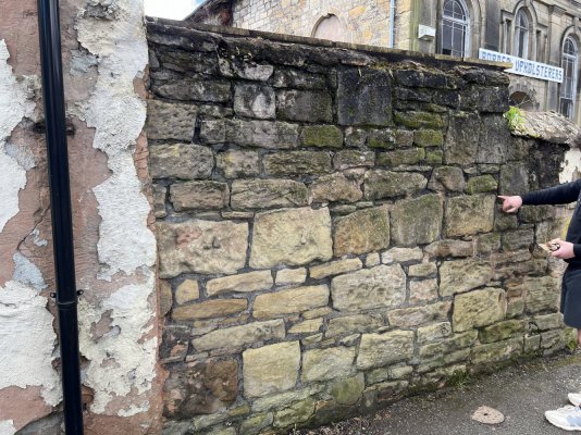

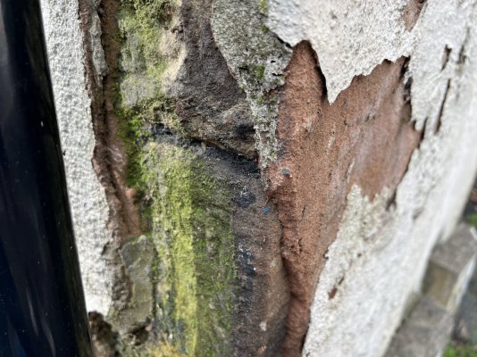

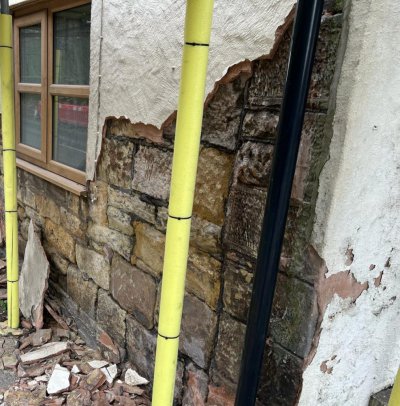

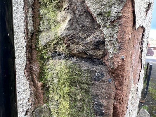

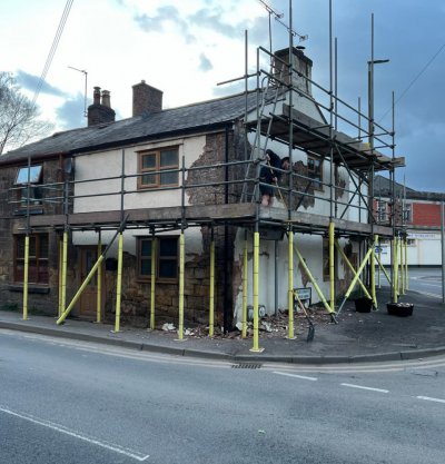

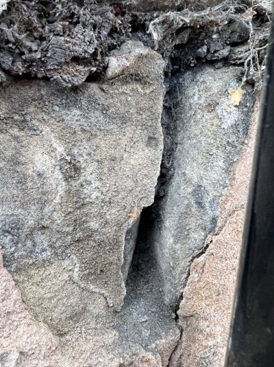

I'm looking for advice on a newly discovered issue having started to remove the existing cement render to an early nineteenth century cottage.

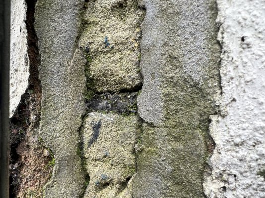

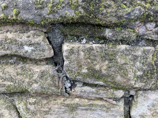

It looks to be two mortars, a very soft, soil earth mortar and a very hard, aerated ash mortar. The ash mortar is almost like just chunks of kiln waste and using the white vinegar trick, there is no fizz, so unsure how much lime content.
Should this be repointed in hot lime, or an NHL mix? How far do I take out? The ash mortar is more like stones, it doesn’t come out in a linear manner.
