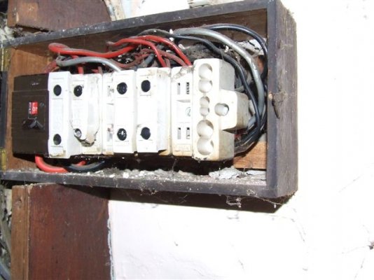

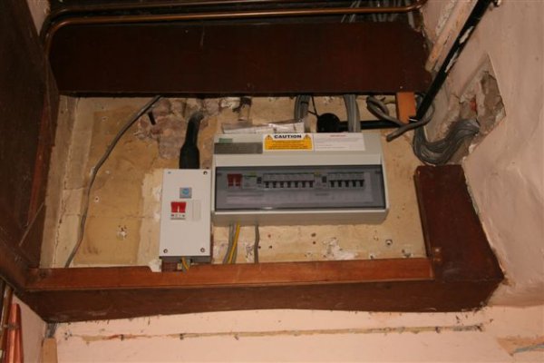

Changed home insurance company this year and they required a conformity certification from a qualified electrician (thatched roof). As my Son has just qualified as a electrician its a job for him
He had a quick look and said you have a rubber cable feed from the box to the lighting circuit, that will have to be upgraded for a start! So he made a start by doing the required testing, which he said 'your house wiring has failed the test' I have some work to do here. Upon further investigation lifting some floor boards upstairs we were both horrified by what we found. Vermin had chewed through the protective cable sheafing to expose wires, how we didn't have a fire we dont know!! Other horrors also quickly emerged resulting in the need for a complete new lighting circuit.
Only eight years ago the house was given a clean bill of electrical health, thats when we purchased the cottage, seems the inspection wasn't up to much as some horrors like rubber cable cracking and perished has not happened in just eight years. By the grace we still have a home.
