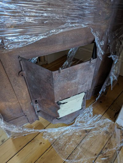

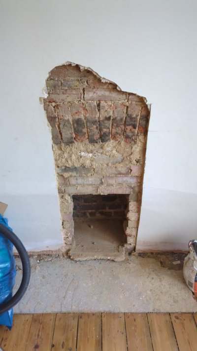

We've got a cast iron fireplace that consists of a surround and an insert. Our existing opening is slightly too small for me to get the insert into it and to get the surround flush with the chimney breast wall. I need to make it around 10cm higher and 10cm wider (5cm each side). The required width is more or less up to where I've knocked the plaster off in the picture.
Just looking for advice on how to do this really? I couldn't see any lintel from the inside of the opening, so I removed plaster from the chimney breast until I revealed what appears to be a brick arch lintel. Looking at the size of it, I'd say the original opening was wider so I'd be hoping it'd be OK to widen the opening a little as it exists now?
I've seen some people cutting a score in the brick with an angle grinder, or drilling a series of holes and then hitting along the line with a chisel but not sure of the correct approach in my case. The rear hearth that you can see (it sits higher than the front hearth) also needs to be removed ideally, so the whole hearth is the same level. It seems pretty tough and it's pretty tightly integrated with the brick of the chimney breast. Am I OK to remove this as well? I couldn't find anywhere else anyone mentioning a hearth slab being structural or key to the soundness of the chimney walls.
I've attached a picture of the opening as it is now and also of the fireplace insert/surround so it's clearer what I'm looking to do. Any input welcome! Also, just to add, I'm not intending to make this fireplace functional at this point in time.
