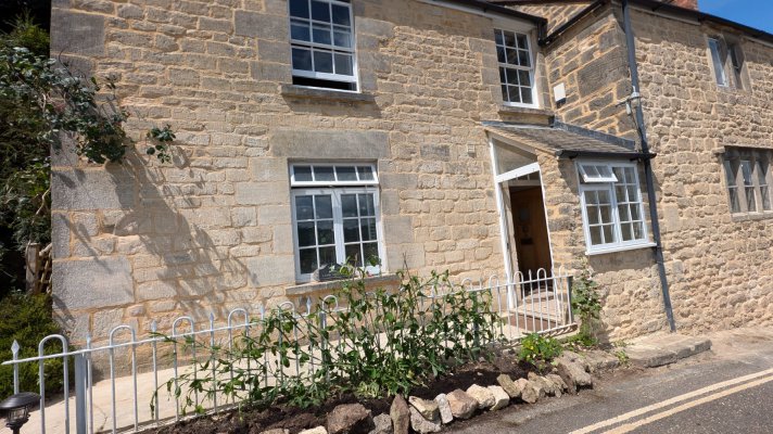

We have a Cotswold stone house, formerly a pub, with various alterations done over many years. Last year we carried out some external stone repairs and replaced the cement pointing with a lime mortar mix.
We'd now like to apply a limewash to the full exterior of the building and wondering if anyone is able to offer some advice on the following:
Image attached is the front elevation showing some of the darker stone above the door and the mullion windows to the right
Thank you!
- Is there an ideal time to do this sort of thing? I understand we don't want it too warm to prevent drying too quickly, but equally should we avoid risk of frost?
- I've read that we should aim to leave 24 hours between coats. What if I cannot even finish 1 coat in 24 hours, will this matter?
- There are some stone mullion windows that have been poorly repaired with what looks like cement in some places, likely before the Grade II listing in the 60s. We will eventually get these properly replaced but for now will need to limewash these along with the stone. Is there any reason why this wouldn't work? Will the limewash adhere to it in the same way?
- There is still some evidence of the the historical limewash on the stone - is it necessary to remove this first, or is it good enough to brush everything down with a dry brush?
- There are some stones which are much dirtier than others due to their positioning and proximity to the road. Is it necessary to clean these first to prevent darker patches coming through the limewash?
- We'd like a pale white / slight cream colouring as this seems to be what was used on the house previously. Can anyone recommend any particular products or mixes?
Thank you!
