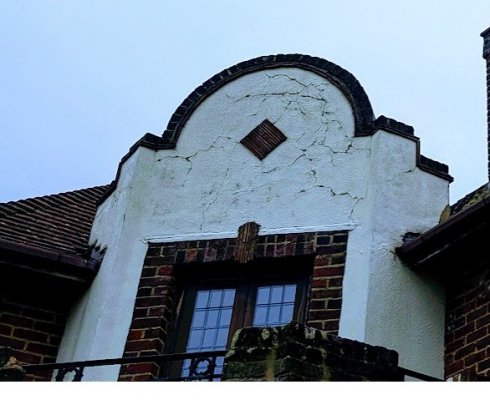

1) External render to the white area you can see in the photo, clearly this has seen better days. I have received a couple of quotes and they both want to go with sand and cement. My thought is this is probably fine for the upper part given there is no internal dwelling there but I am wondering whether it may cause problems in the lower sections given this backs off to photo 2... Is sand and cement suitable, or a silicone render? or....?

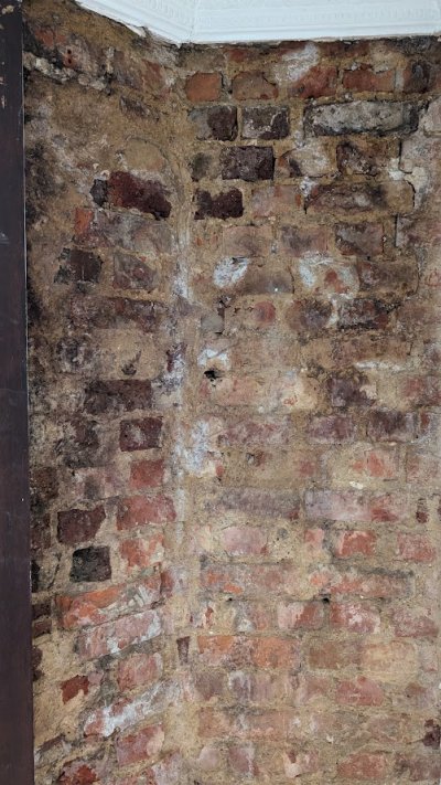

2) Photo 2 i.e the internal bricks, this was covered in a plasterboard and had the old lime chipped away (probably when it's got wet historically with the flat roof failing). The suggestion again is to put a waterproof render over this, then a plaster skim. Again the suggestion seems to be that the base 'render' is sand and cement with some water proofing agents. Is this suitable? if not what would you suggest? Also there are a few holes in the lime mortar, would you fill these with lime before render/plaster? Again the plasterers seemed to think it didn't need it and the render coat would make this good.
