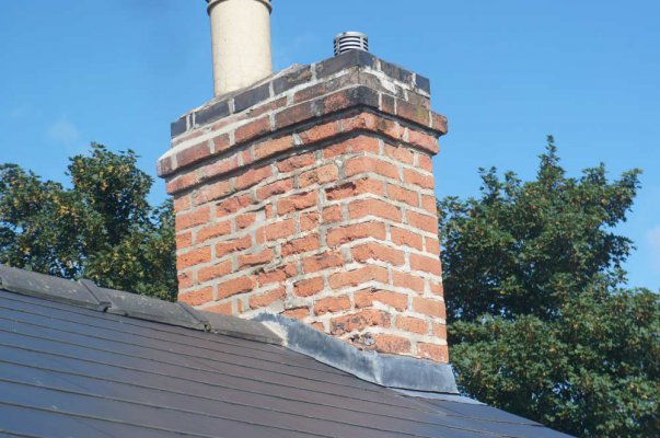

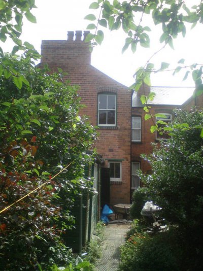

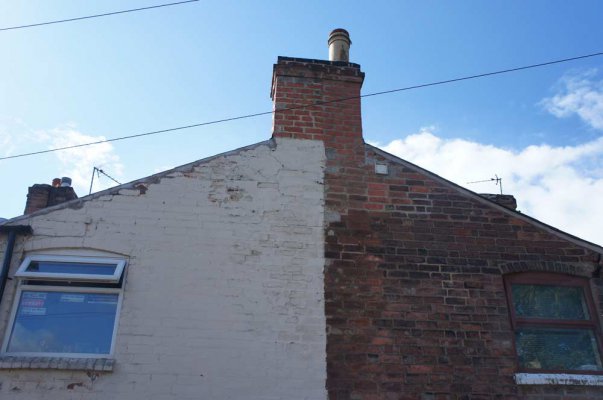

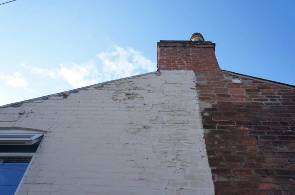

I have an 1800s terrace property where the rear wall has been badly weathered and affected by damp in the rear chimney stack.
The previous owner has made some attempt to repoint, bodged it and then just painted over it – hence it looks a mess. I’ve had a quote to render the rear wall (based on the fact that it’s weathered beyond the stage where I could remove the paint and repoint)
The builder is suggesting a couple of coats of SBR bonding agent, two coats of 3/1/1 sand cement lime mortar with nylon fibres and then one coat of limestone chippings.
He seems to know what he’s on about and claims that this will hold and not crack.
Reading about rendering issues on old damp period properties, it seems pretty clear that whatever he does has to be breathable – will this do the right job or should he just be using lime render rather than a cement lime mix?
