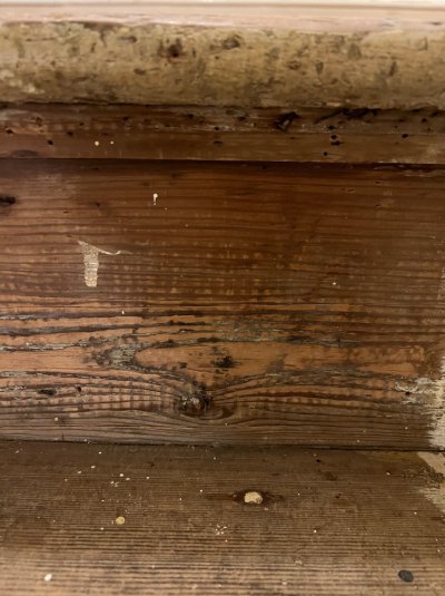

After having the pine floorboards loose for so long I’ve decided to finally fix them down again. I don’t think I can take much more of the wobbly floors - I think there’s a slip/trip waiting to happen. But after looking under the floorboards at the joists I have a problem; in many areas, as the floorboards have been lifted and reattached a few times, I’ve run out of places to fix them I.e too many holes or thread erosion.
I also have a goal - to make it easy/painless to remove boards as and when needed. As I still have some CH pipe work and data cabling that may need doing, I know some of these boards will have to come up again so I am thinking of doing the following:
- repair the joists that have run out of fixing space I.e. too many holes. I’m going to drill holes in the joists and hammer in hard wood dowel joints into the joists. Hopefully then I should be able to fix the boards down.
- fix in some threaded inserts into the joists (e.g. EZ Lok) so that I can remove and reattach floorboards without worrying so much that I’ll struggle to reattach them.
Apparently the latter is a favoured technique.
I plan to test this in one discrete location, but I’d love to hear how folks on here have solved these problems.
