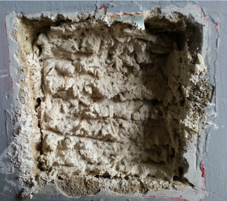

Recently bought an 1880s semi, there are many like it but this one is mine. Solid walls of very soft red brick, and from what I can tell it's mostly lime plaster with a few patches of something else. The gable wall has been soaked over the years thanks to dodgy roofing which is now remedied. I've just had the house rewired leaving lots of beautiful large chases in the walls or around 4cm deep in some places. On the damp walls they've had to use lots of foam to secure the new boxes. Old boxes have been left in place too which I want to pull out and fill.
- What's the best thing to fill these chases with? All the advice outside of this site seems to say use bonding, but I think that's not so good for these walls? Should I use anything different on the external walls?
- In many places the conduit is quite tight in the chase. Very noob question but what's the best way to get behind it, or should I just be pressing whatever filler in as deep and firmly as possible?
- To fill the old disused electrical back boxes I assume it's best to try and use an old brick to fill the void?
