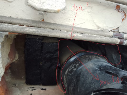

The time has come for me to make good the gap(s) in the external wall that were knocked through to accommodate the new soil pipe. Ordinarily I'll cut some original bricks to size and lime them in, but this gap with the soil pipe is trickier and got me thinking...how to detail it over the top and around the pipe? As you can see its quite a deep space.
I know how the trades would do it...expandable foam and cement to finish. I'm not anti-foam but I'd like to avoid it if possible. I want to employ some flexible wood fibre on the internal side of the void to fill some space but for the external side I'm thinking layers of lime mortar with layers of slate and/or bits of broken brick embedded, to help with shrinkage and provide ballast.
Its just laying lime on top of and around a plastic soil pipe seems a bit odd, would you do the same?
