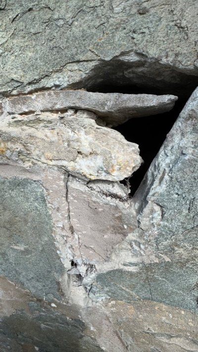

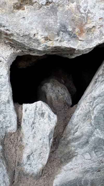

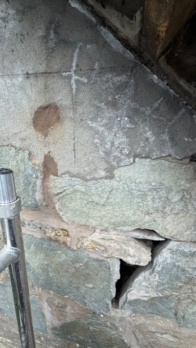

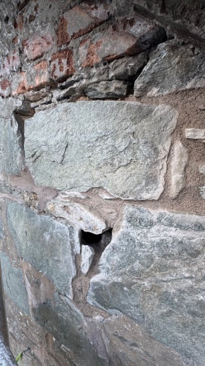

As part of my ongoing pointing adventures, I've found a problem that I'm not sure how to tackle. Advice appreciated.

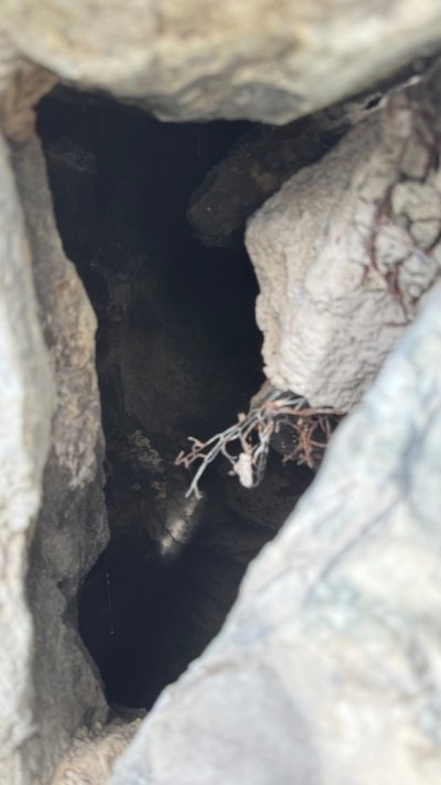

Pictures aren't great but basically after chipping away cement repairs I have a gap in the outer leaf all the way into the fire flues. This sort of straddles the two front flues, upstairs is capped off, but downstains still has a fireplace and I've verified that's where it goes by dropping a stone down...
How should I build this back up? Both of the big stones either side actually slope inwards so the gap is wider the deeper you go. There is the remains of the bit that divides the two flues just to the right of this opening which is quite poor too.
The downstairs fireplace won't be used without a liner. Do I need to worry about building up the masonry dividing the flues? If anything the gaps might be helping ventilate the upstairs flue.

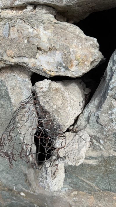

Previously it was repaired by pushing chicken wire into the gap and then cementing over that. Would that be a good approach? With appropriate materials like stainless mesh and lime mortar of course.
Or should I dress those two big stones either side to get a straight edge and give me space to work, then build up the dividing wall back into the front leaf. Then use that as a back-stop to build back the leaf.

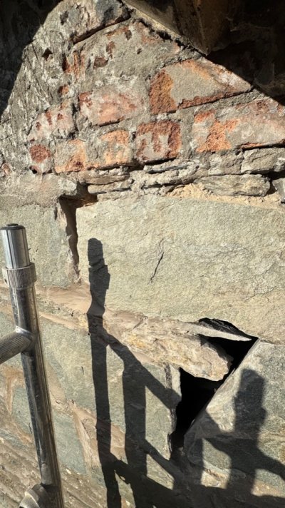

This is just about the top course of stone before the chimney stack. I'm fairly certain the chimney stack has been rebuilt in brick and then rendered. How worried should I be about the stability of the chimney if I remove any more stones? A wider shot would probably help answer that.
And finally that big lump of cement with the wire embedded in it won't come back through the hole because of its shape, so I think I'm going to have to drop it down the flue. Would it be better to drop it into the upstairs flue that's capped off rather than having it rattle down the downstairs one that I hope to use one day?
