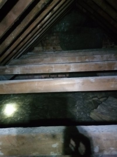

However, this doesn't look in great shape. At the far end of the attic is look undisturbed
but closer to the hatch it's a bit of a mess.

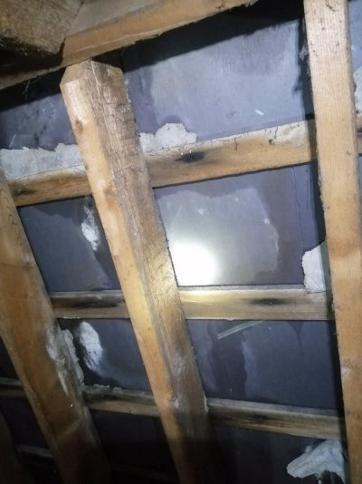

I have done a little reading into these properties and understand I need to be careful about moisture control, airflow and all of that. The roof is slate with no felt. I don't believe there to be any membrane or anything beneath the insulation but I realise I did not explicitly check this when up there! Below is a picture of the back of the tiles. It had rained that day, but I am not sure if that is moisture coming in or going out? Also not sure what the white material is on the back of the tiles?
