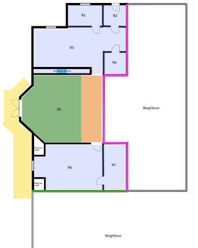

I live in a ground floor flat in a large Victorian building. It's 13 flats in total, we have approx. one quarter of the ground floor, attached is a rough plan.
Legend
Legend
- The exterior walls are mostly stone with some brick trimmings, those that I've been able to measure seem to be about 80mm thick.
- The pink and green walls are party walls with neighbours.
- The 'ground' level of the lilac areas are all the same, and the same as the outside ground level at the front of the flat (north on the plan).
- The orange area is a suspended floor which comes up to the same level as lilac. It's wooden joists on brick pillars about 35cm above a concrete slab.
- There are two steps down from the orange area to the green area, onto the concrete slab. The green area has also been screeding with a self levelling compound and had a wooden floor down when we moved in. We removed it because it was damp/rotten at the perimiter.
- There are two steps up from the green area to the yellow area outside, making the outside ground level ~35cm above internal (at least true for the bay area of R5). It's a concrete path. The exterior ground level around R1, R3, and R6 match the current internal height, but as I say, this is a concrete slab so I've no idea how thick that is and how many courses of stone have been covered inside and outside by renovation work.
- The chimney is boarded up and capped and we have no plan to open it up, but I have added vents on the lounge side as an area of the plasterboard wall covering it was damp when we moved in.

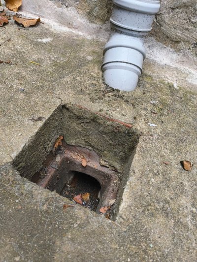

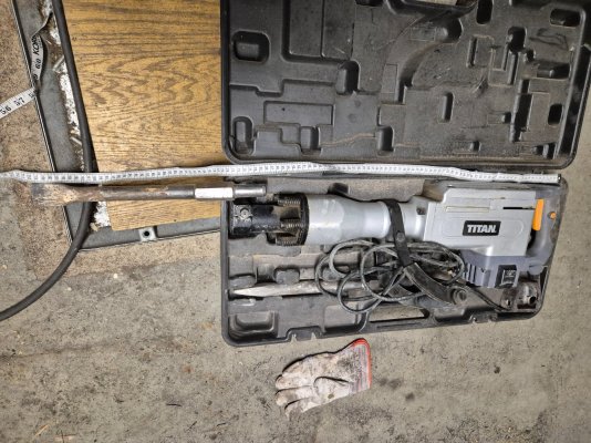

- Lower the external ground level at least in the back garden (yellow area) - I would need a concrete breaker for this and my partner is (understandably) nervous about taking the DIY approach and what we might uncover with respect to the building foundations. I'm reasonably keen on this as whoever did it, has embedded the ends of the plastic downpipes in the concrete, so I have no idea if these could be split or misaligned from the drain at the end.
