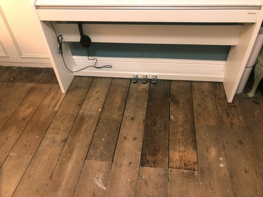

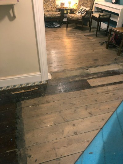

Hi. I have some late victorian pine floorboards that I'm looking to sand, possibly stain and then finish. They are not in bad condition but there's lots of old paint splatters and some rough areas and scatches so I feel the whole floor would benefit from sanding and finishing. I've read Toby Newell's excellent website and I'd like to give it a go myself.

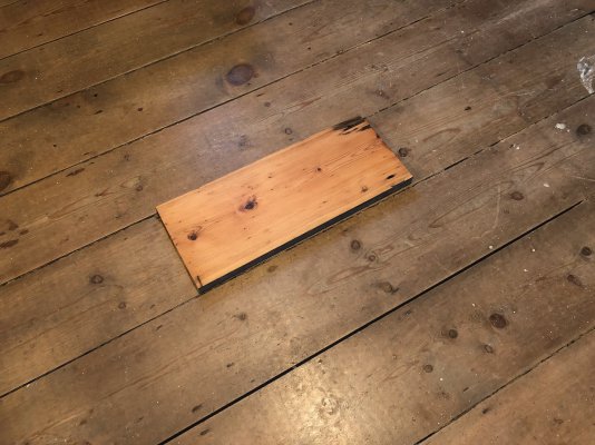

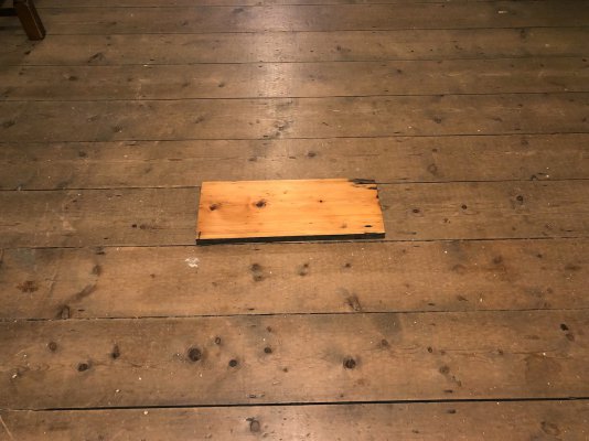

As a test/experiment I took a section from one of the original boards (which I had needed remove anyway) and sanded then applied one coat of shellac (Mylands Shellac Barrier Seal) and then two coats of water based polyurethane lacquer. When I sanded the board, the bare wood did look a bit yellowy (as pine does) and I feel with the finish it is a bit orangy (see photo showing the finished test section, and the floor as it is). I actually like the brown of the floorboards as they are or something a bit lighter.
So my question is, when I come to sand and finish the whole floor, how can I tone down the orange and get it to a colour that is something aproximating how the floor looks now. Should I use pale shellac instead of shellac barrier seal, or is there a dye I can add to the shellac? From Toby Newell's site he suggests perhaps a water dye with a bit of green added. I'm fully aware there is a whole art to this and I am just a DIYer without any of the experience needed to get the perfect colour. But I'm wondering if there is a method to achieve a bit more of a light/mid brown, and crucially, one that I've got a fighting chance of being able to apply without screwing it up.
