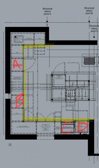

Evening all, we’re finally close to a new kitchen being manufactured, only 11 months after designing it!
The room is an old animal shelter, incredibly thirsty old red brick solid 9inch walls. Ground levels aren’t our friend as we’re built almost on top of limestone bedrock, 300mm footings. outside levels aren’t much below inside as they can’t be. And limestone likes to hold onto water or worse still offer it up when it rains!
Floor is ok, RFG with limecrete and UFH which runs to approx the unit edges, but not fully under.
So the walls will get damp from the ground as the bricks love to suck up moisture. They’re not plastered behind units, we’ve left a nice air gap to offset cabinets from the wall.
What I’m designing now is how to force airflow behind and under the cabinets to get the damp air out and dry the walls.
The plinth is a decent height and there will be regular air vents every 500mm or so.
Computer fans on timers are a contender, but how many and where? and do they push, or pull, or both?
On the pic, we have warm appliances, all uncounted counter integrated. Only low level units.
A - freezer
B - fridge
C - dishwasher
D - ovens
What are we thinking?
