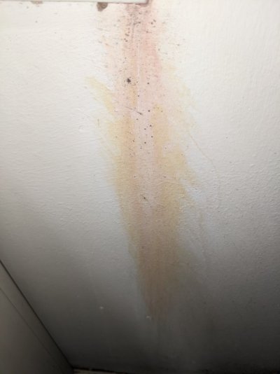

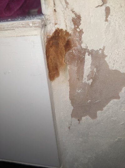

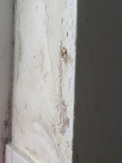

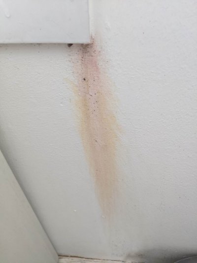

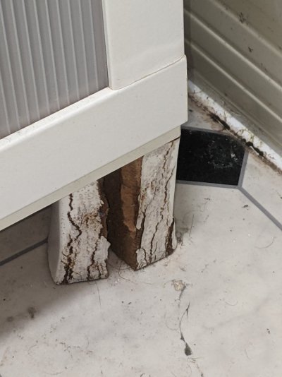

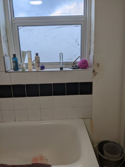

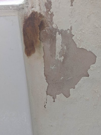

To my mind the lasest pictures from Happy provide clear evidence of some fungal infestation and I would strongly urge that a specialist is engaged asap and certainly before the final contracts are exchanged!
