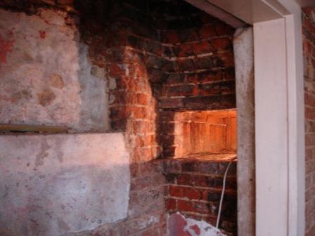

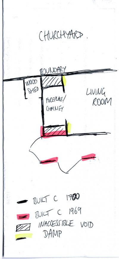

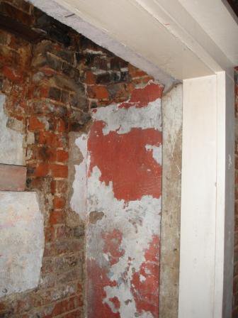

So, I have an old house, 17th century or thereabouts, and it has some inaccessible voids either side of the fireplace. The house is solid 9 inch brickwork. The fireplace is big, around the floor area of a bath, and about 5 foot high. I've drawn a quick sketch, attached. There is damp inside the house next to each of the voids, and I think it could be because the voids are filled up with builders rubbish/mud/stuff, which is effectively raising the ground levels inside these voids....
It might be nice to clear them out. However....
One of them seems to have been closed in a long time ago, because it has old lime mortared brickwork on all four sides. The other seems to have been closed in 1969, when the property was extended.

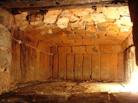

The 1969 one I opened up today, by knocking a hole 9 inches across or so, through the 1969 brickwork. Lo and behold, it was filled up with builders rubbish to about a foot above ground level, and the original outside wall of the house still has the concrete render which I've removed from everywhere else. But I found asbestos in the hole too, so I stopped excavating.
The void near the churchyard is more tricky. The boundary of the property is the back wall of the house, so I can't excavate from that side. I don't want to dismantle the wall of the living room. I don't want to dismantle the wall that's holding the chimney up (although the void may originally have been open on this side - it could have been some sort of bread oven?). So today I carefully took a few bricks out from the side of the woodshed, to try to see what was in the void. But behind the bricks I took out was another wall, and I sort of got the feeling I shouldn't be doing this so I stopped....
Should I just ignore the damp patches and leave well alone?!!!
