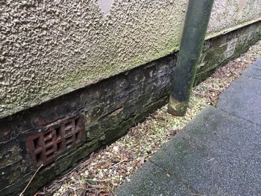

We have a solid gable wall on our 1904 semi-detached. It's double skinned and has been rendered in sand and cement. As you can see from the pics the render doesn't cover the air bricks and there's a French drain at the bottom.
This drain appears to be draining effectively, in that the pea gravel isn't any wetter than you'd expect it to be under the surface layer and I haven't seen any worms or anything that would indicate blockages.
The bricks at the bottom of the exterior side seem to be pointed in some kind of tarry black substance. I assume this is an attempt at damp proofing.

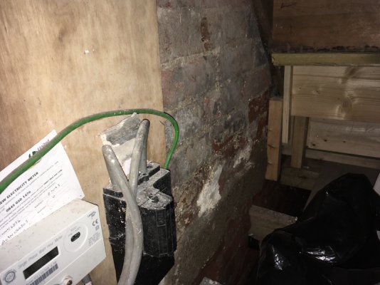

The render is blown in several places, so needs at least a repair job. Inside, the wall is dry except for the bottom couple of feet. I don't know whether the damp at the bottom spreads across the whole wall or just the section where the bricks are exposed in the cupboard under the stairs:
There have obviously been serious damp problems on the ground floor where it meets the gable wall in the past. All the flooring, including the joists, have been replaced along this wall. The plaster has been removed up to about a metre in the under stairs cupboard and there is a clear line where the damp stops a couple of feet above the air bricks. There was evidence of dry rot on the cupboard door frame, so when we bought the place we had an independent damp surveyor look it over. He said the dry rot was old damage and there was no active rot and the wood just needed replacing, which we've now done. His assessment of the damp on the exposed bricks was that it was condensation.
Where there is still plaster and wallpaper on the rest of the gable wall, it feels cold to the touch but we can't see any actual damp patches. There are a few places where it sounds like the plaster is blown so there are repairs to do. Large sections have also had a layer of renovating plaster skim added, presumably as some kind of attempt to damp proof it.
So, my first question for the experienced and expert out there - would you agree with the surveyor's assessment that this damp on the inside is condensation, rather than penetrating or rising (I know rising is now thought to be vanishingly rare)?
We have been ventilating the house as much as possible since we bought it - we removed all the old carpets, laminate etc, have cleared the air bricks and installed a stove which is hopefully circulating the air. When we've looked under the floor in the hallway the movement of cobwebs tells me that air is moving well around the sub floor.
A couple of months ago there was actually beading of water on some the bricks in the under stairs cupboard, which isn't appearing any more - is this a sign that our ventilation is working and the wall is drying out? What sort of signs should we be looking for that it is drying, and how long would it take to dry?

- rake out the tarry black stuff from the bricks at the bottom of the exterior side of the wall. Re-point with a softer (lime?) mortar.
- is the pea gravel okay in the french drain or should we replace it with a larger sized stone?
- given that there doesn't seem to be penetrating damp on the inside of the wall, should we take the "if it ain't broke" approach to the cement render and patch repair in cement? Or should we have it all taken off and re-render in lime? Or some other solution (all the builders seem fixated on K Rend or similar but I have no idea if this is really suitable. I'm assuming the bricks will be in too much of a state to have the render removed and just repoint them - also we might fall foul of building control and the old 25% change to thermal elements thing.
- Add vents to the door of the under stairs cupboard (at the moment I'm leaving it open a crack). It smells musty in there but I think it's less musty than it was!
- remove the layer of renovating plaster from the interior wall and let it all breathe / patch repair the original plaster (likely to be lime in a house this age?)
