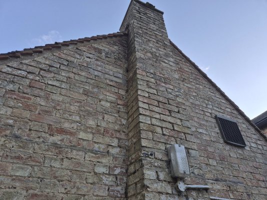

I'm planning to add a 2.5m opening in the gable of my barn. I'm keen to have a sanity check.
I'll use a steel lintel 3m wide. It's not holding a lot of weight but I'm going heavy duty 230mm tall just because it's cheaper to overdesign than pay for calcs. I have this thing in mind: https://iglintels.com/product/ibeam-3c/
Plan is to remove the chimney down to just above roof level, insert a number of acro props, make a slot for the beam, install it, then remove the chinmey by taking out a few courses of chimney bricks at a time from below and building back up in line with the wall, the idea being to leave some structure in place to keep things stable. I have a super tall acro to support the ridge beam while this is going on.
Does that sound like a sensible sequence or is there an easier way?
