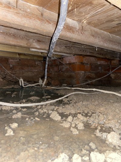

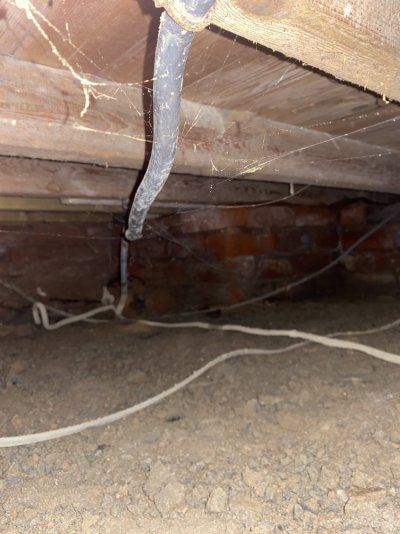

I’m getting suspended floor insulated next week and will have access under floor . We do get occasional water under there (clay) but it tends to soakaway fairly quickly the clay seems mostly wet to touch after all the heavy rain .
Would it be worth laying some geocell glass foam down there to a certain level to help manage the moisture and have less damp clay exposed ?, I have about 45cm in depth to play with and looking to do something practical to help. The airbricks are fairly high so these would not be blocked.
I can see it being used with limeCrete floors but unsure if it’s worth it when just a loose fill.
