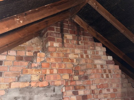

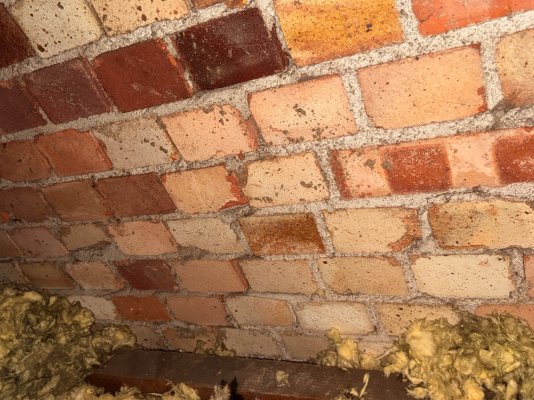

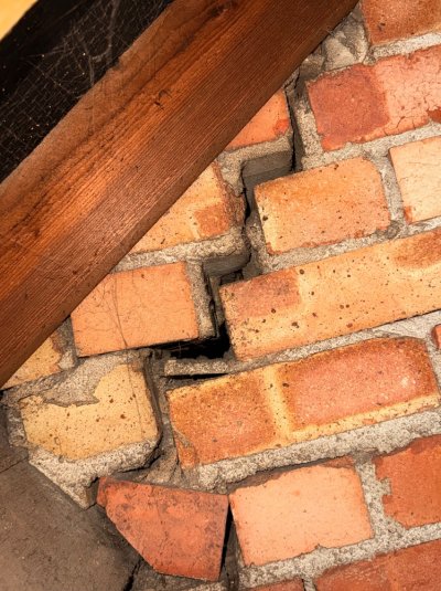

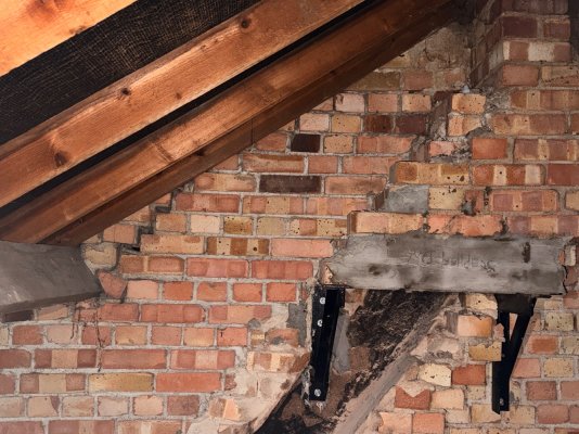

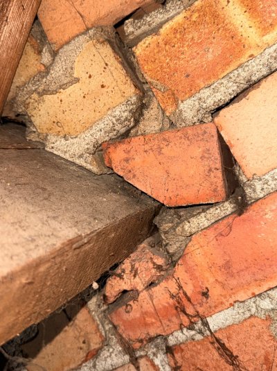

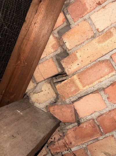

The area bellow doesn’t have any separation at all but the mortar looks slightly disturbed with the same pattern following thorough on the bricks, but again these are not large gaps and are more hairline. Hopefully you can see this clearly and get a better idea. Thank you so much!That timber going into the wall next to the cracking is a purlin, does the cracking/movement continue on past down to the left of it?
If it does that might indicate the roof is spreading and you might want to consider putting in some timber (might just be some collar ties) to tie the rafters on either side together and prevent further spreading.
If it’s all fine beneath then potentially someone just got a bit enthusiastic during the chimney breast removal and the bricky can make good again
