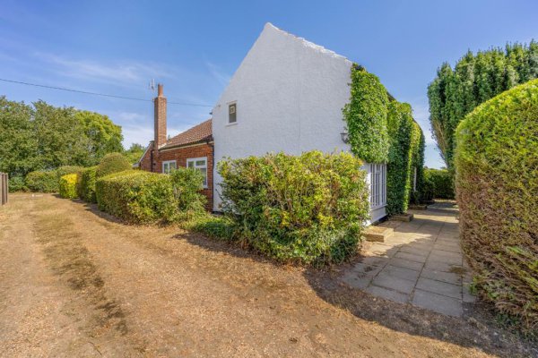

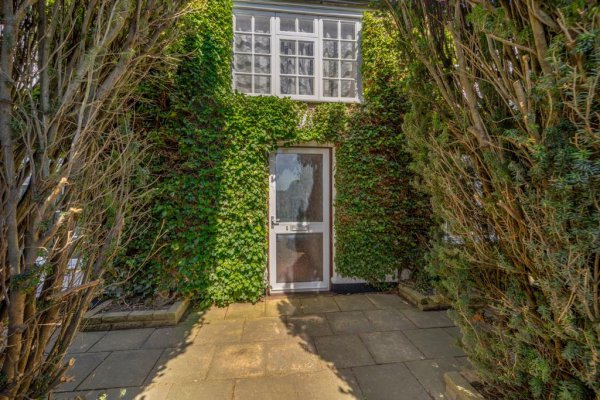

Too-high ground levels are a common problem with older properties. The good news is that it's a known problem with known and proven solutions (good news in the sense of not stumbling around trying all manner of random things to see if anything works). Replacing slabs with gravel should also help, though don't underestimate the capacity of gravel to hold water, even though it's certainly better for drainage than paving slabs, so reducing the ground level is still important.
Personally, I wouldn't rush to install a DPC. Your point about 'good ventilation' is bang on the money but don't expect it solve damp within the walls/floor particularly fast. An often quoted figure in these here parts is that a damp wall can take around one month per inch to dry out, ie a 9-inch thick solid wall that has been standing in damp-inducing conditions for years might easily take 9 months to readjust to its new environment when improvment works have been completed.
I'd endorse Eric56's post above, ie do the obvious basic stuff first (ground levels, foiliage removal, checking for guttering leaks etc), then just 'live and learn' for at least a year - you'll learn how the house and its environment 'works' and also the house will gradually find its new equilibrium with the basic changes and your lifestyle. Plus, you've rightly mentioned 'good ventilation', which can solve all manner of damp-related issues without the expense and disruption of installing a DPC.
Also, based on my own experience, 'good ventilation' doesn't necessarily mean wide-open windows all year round. I think of it as being averaged over a year. In the summer months, our windows and doors are always wide open, in the spring and autumn they are generally wide open during the warmish days but closed at night (mostly) when we have the heating on and more often closed than open in the coldest months. So indoor winter humidity levels will likely be a bit higher than summer levels but with adequate average ventilation, damp will not accumulate. Buildings react slowly.
Houses don't suddenly have a damp problem because the gutters start leaking or the outside ground level is raised too high with paving (for example) - but such changes in conditions will cause a change in the environment for the worse and the gradual build up of problems will begin. Left for many years, the effects eventually manifest themselves (in this case, damp problems), at which point many people start to panic and look for a quick fix and of course there are no end to 'snake oil' solutions out there. Alternatively, reverse the basic problems and give the house time to heal itself while you get on with living your life. You'll learn to love your new house and it will learn to love you.![]()
