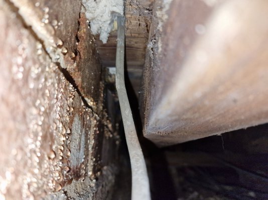

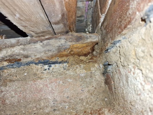

I recently moved into a semi detached 1930s property in East London.
Survey said it possibly had damp issues.
One wall in particular, seems to be the problem. Particularly under the suspended floor.
Solid wall construction.
The wall is an external gable end. Facing the shared alleyway between me and the neighbour.
The brickwork below the suspended floor is covered in condensation. It's rotted out multiple joists closest to the wall.
I've checked for leaks. No issue there.
Patches of mould all over the wall in different rooms. However the worst part in under the suspended floor, in between two airbricks. Roughly 2.5m to the closest one.
I'm thinking it needs better airflow. The rotting and soggy sand/cement needs to come out.
But is that enough?
