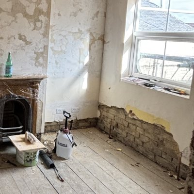

I’ve started renovating a Victorian property in central Cambridge.
Behind where the skirting board was is just brick wall and in places the plaster crumbled a fair bit (ref photos).
I need to move into the house in 2.5 weeks and want to move the project along without injuring my arm any further (I rebuilt an entire lath and plaster wall).
My question: should I still use haired lime mortar etc on the outer walls where the old plaster has failed (and leave the inside walls to the plasterer to finish off) or would the repairs with regular plaster not matter on what is essentially a smaller surface?
