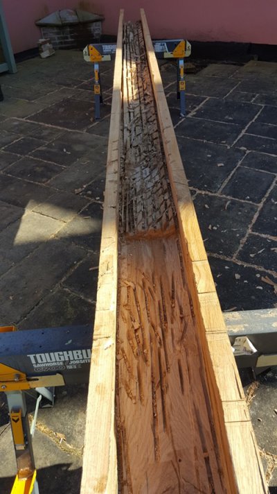

Have spent the last few days on and off hollowing out an oak beam to fit over a RSJ. Chainsaws are working overtime. Whilst having a glass of wine perusing the forum I thought I wonder if anybody has a better idea than me.

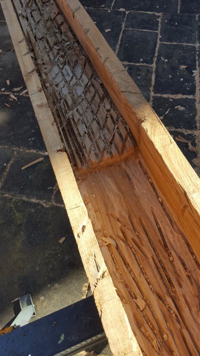

I have cut the beam down to size and got the sides of the U sorted out it is just a slog to finally hollow out the centre. I do it by cutting numerous slots with a chainsaw then chiselling out, works but is laborious. I cannot think of any method/machine which might quicken up the whole process. Attached are a couple of photos.
