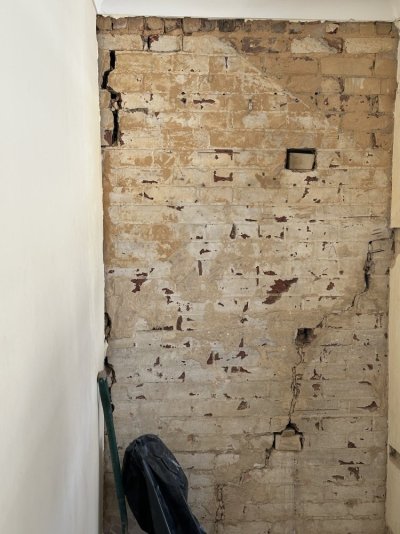

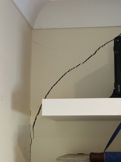

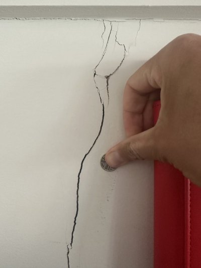

We’ve noticed cracking appear in the kitchen and upstairs in the spare room directly above. This is on the party wall. We know the neighbours had it, not that i’ve seen it but understand it was quite bad. They went through insurers in 2022 and they sent out an independent company, they went through the floorboards, found no signs of subsidence but suggested lateral movement caused by our previous remodelling and fix by stitching using helibars and resin. They sent us the report, i don’t believe they’ve made any fixes recommended.
We noticed the cracks appearing in our kitchen, spareroom and spare room ceiling getting worse, all on the party wall. We brought in builders and SE who uncovered the plaster and found three issues

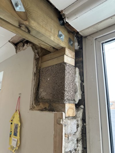

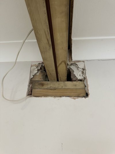

He did not use steel (sp?) beam to support removal of the wall
He did not use suitable lintel for outside windows

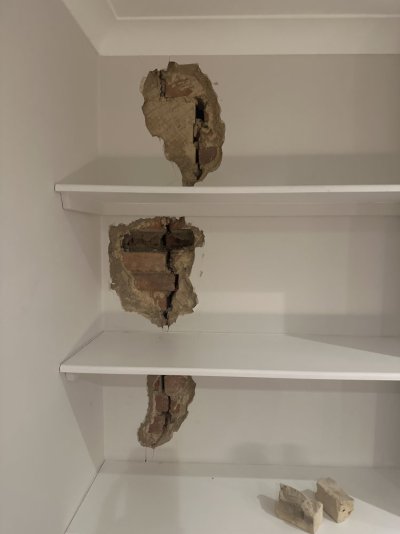

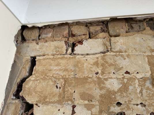

Cracks in the brickwork leading up to spare room.
The first two issues appear to have a ‘simple’ solution and are in hand.
The third one, the cracks is what is concerning. The SE also said there are no other signs of subsidence, the chimney has been inspected, a drain survey also done and came back all good.

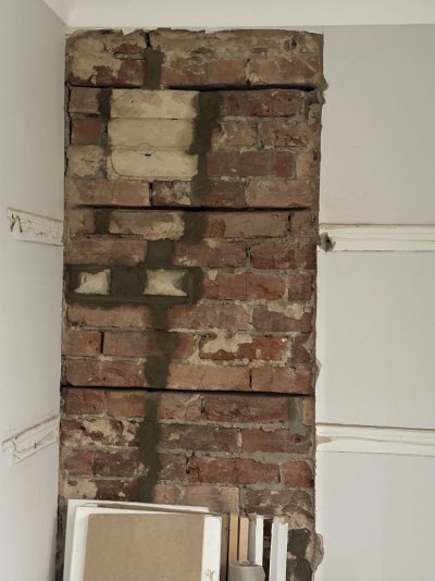

The fix has been suggested as also helibars and resin. This is currently underway.

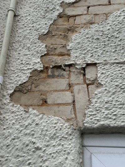

The builder said something today that has knocked us for 6 to be honest. Whilst speaking to him about how they’re getting on he said he has returned to the SE because he believes our mortar is crumbling. He picked up a small section and crushed it in his hand and was very sandy. I asked what this meant and he said it was likely we would see this cracking issue appear elsewhere in the house and the only way to resolve is to demolish the house and rebuild! I know this isn’t covered under our insurance, and we would lose everything. I’ve included photos of the various stages of what’s happened so far.
