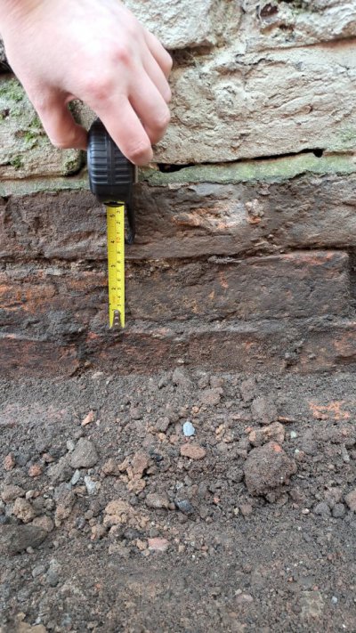

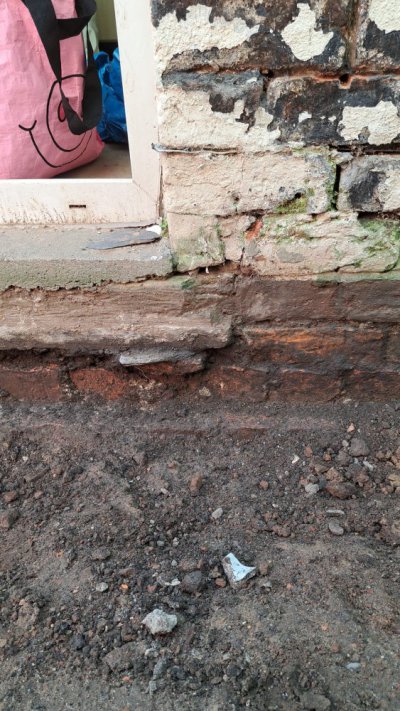

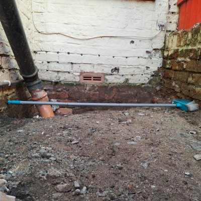

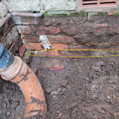

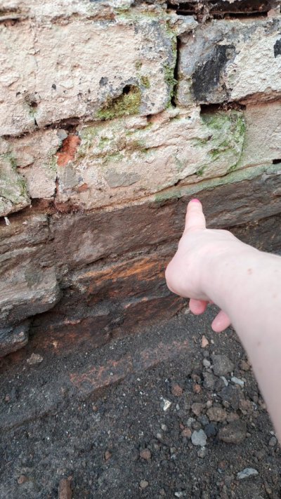

We are lowering our outside ground levels and this is what it looks like: a work in progress.
How far down should we go? Any help appreciated.
We think we have found the original slate damp proof course and attempt to go down two bricks (150mm) below this.
And then fill with a French drain with gravel and a perforated pipe which will go directly into the hopper combined drain. We’ve dug to the first brick footing of the house, will it be okay to put gravel directly on top of this with the pipe, and then ensure the patio is at this level for the rest of the side of the house?
Will the foundations be okay?
We will also ensure that the ground slopes away from the house so water drains towards the garden area and not towards the house.
