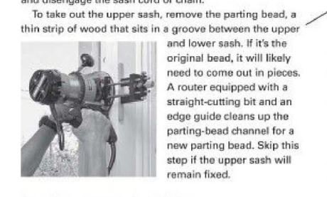

What method, tool would be recommended to increase the depth and width of the existing parting been 'groove'

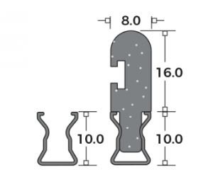

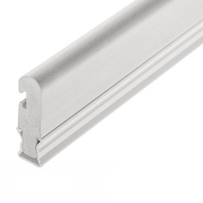

Reddiclip – Parting Bead with Channel
Channel fits into a 8mm wide x 10mm deep groove Channel is pinned into the groove Parting bead simply inserts into the channel and clips securely into place Parting bead will not come out in operation, but can be easily unclipped for renovation or replacement Standard 8mm wide parting bead...
