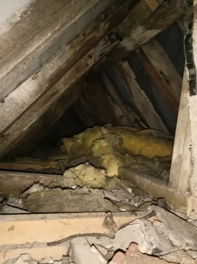

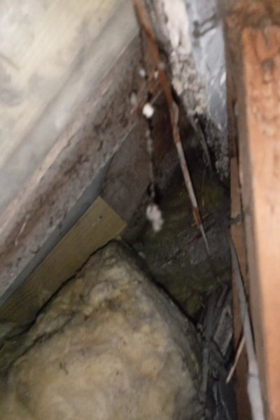

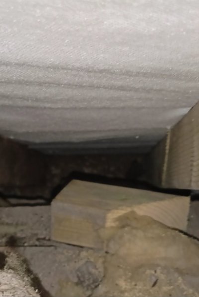

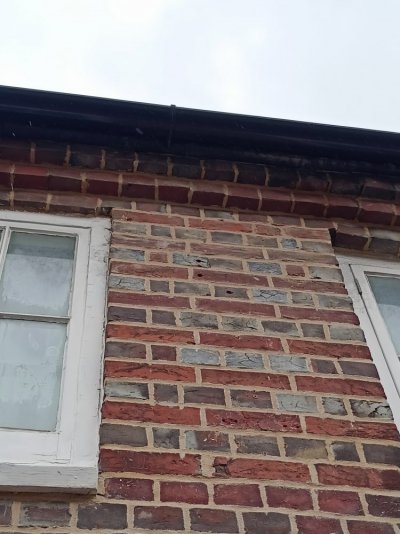

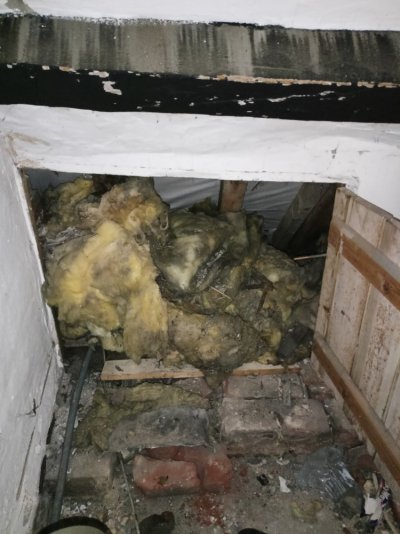

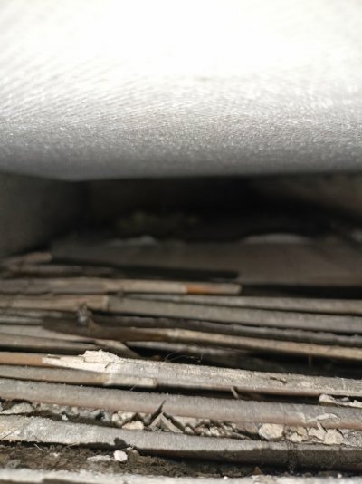

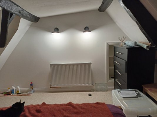

I bought a late 19th century grade 2 listed property earlier this year. Leasehold in a converted property 3 1 bed flats and my 2 bed maisonette. My bedrooms are in the roof of the property.
Due to the recent cold weather and knowing my stop cock is in the roof space, I've been investigating a little bit to see what insulation is in the roof and surrounding areas.
It's in an interesting state, so I've been looking at options available to me. I have a load pics that will show more than my limited abilities to describe.
Building was converted in 2006/7 with the roof tiles lifted (some point in the last 10 years) and a modern roofing membrane installed. There is a 50mm ish gap between the membrane and plaster. Rock wool in the eaves and also in the ridge space (barely). There is no ventilation that I can see in the eaves/soffit or at the gable ends as it's in a terrace. So I'm struggling to understand how it all works and fits together in terms of cold/hot roofs and what I could do. There is no problems with damp spots or the like. But I've only just gained access to the ridge/eaves to monitor any condensation issues up there.
It's all in a poor state as you can see, just working through my options at the moment, so any thoughts, advice, knowledge etc is great appreciated. Any questions please ask. Thanks.
