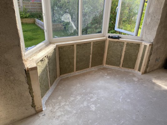

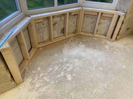

Could anyone suggest a simple way I can insulate this single skin bay window? I was originally going to wood fibre and lime this wall but after issues with installation I ended ripping out and having frame built. Plan now is 15mm wood wool on top of frame with lime on top. The rest of wall being 3 coat lime with some form of insulation in the frame (the bay wall has a lime scratch coat on) - the frame gap is around 100mm deep. I do have a load off wood fibre offcuts left which is a mix of 40mm and 60mm - was thinking maybe I could sit it tight in frame or considering just putting mineral wool in frame but not sure if I need VCL etc , just want to keep it simple as looking to get the wool wool board put on and plastered later in the week.
