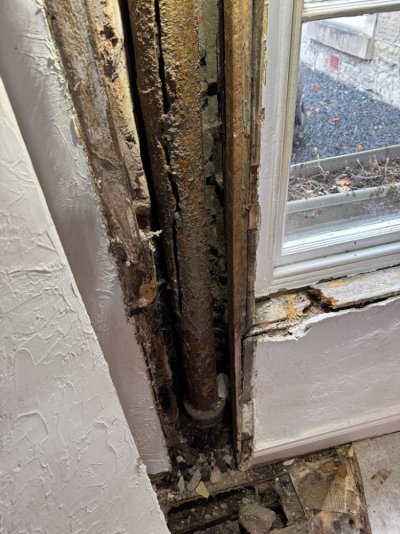

I have a dry rot problem with a known cause - water escape from a walled-in cast iron waste pipe possibly blocked then cracked from freezing some years ago. This cause is covered by my Hiscox Private Insurance but after confirming this they are doing their best to get out of it, loss adjuster appointed, full building survey trying to find if I have misrepresented the property in any small detail, waiting for a 'forensic dry rot specialist' coming from the Home Counties to Scotland. Before paying out a single penny they have ramped up my March renewal from £2950 to £4950. I've documented the problem in detail with photographs, paid out £780 to have the cracked pipe removed and a new plastic one put in to be able to use the baths/basins and a washing machine on the floor above. This is never covered by insurance - it excludes the cost of repairing or replacing pipes in the event of water ingress, but covers the effects of the leak. Every professional who has looked at the issue from the first local timber treatment firm recommended by a builder I got in to put new floorboards in a corner (he spotted the dry rot, I was unaware) agrees on the cause as a concealed intermittent water escape.
The insurers asked for an intrusive/destructive investigation, first uncovering the pipe (which is when the crack became evident) then hack off plastic, lifting floorboards, digging into solid flooring etc. The firm used charged about 50% more than their £480+VAT base price - this element is covered by the insurance officially, £500 excess, and basically I'm only £260 down on 'claimable' costs but £2000 more on their hike in insurance, assuming they do pay out. The quote resulting from this survey was £48,500 and that excludes many additional costs like flooring and reinstatement of the (very high end solid wood) kitchen which must be stripped out. But I didn't trust the costing and do not agree that the suspended floor of a circa 1830 kitchen should be replaced by a solid floor, or that larder and store room solid floors need excavating or plaster stripping to ceiling height (etc).

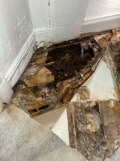

I've now paid out £180 for an alternative dry rot specialist to look it and he's said no way a Regency house with designed in airflow in the solum should have a solid floor put it, and he also says that existing solid floor areas need excavating - says these and the walls do need drilling, spraying, replastering to 1m as the hyphae can only be seen to have followed the base of the walls at the edge of solid flooring to reach door frame timber. The airflow has spread a blanket of spores under the wooden floor and infected an early 20th c tall kitchen cupboard, flooring under it, and adjacent wall but all this can be seen clearly and brick exposed at 1m height shows no sign of spread upwards. He has given a ball park cost HALF that of the first company, including putting in a new wooden floor with heavier joists, possibly avoiding removal of some of the kitchen units. Waiting for a formal quote but he said £30k tops. He also made useful comments on the masonry outside, historic incorrect pointing using cement not lime mortar, damp course injection (1988) etc.
