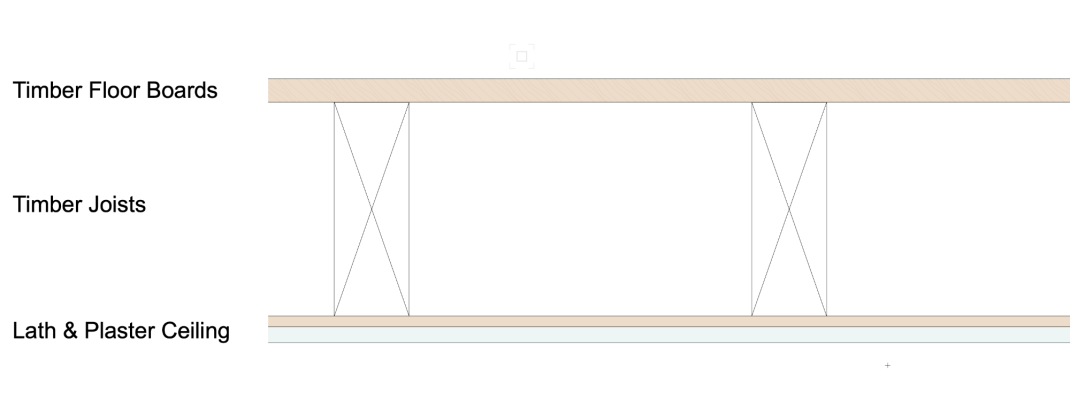

Our first floor buildup is typically joists with a lath and plaster ceiling directly to the underside and timber boards on top - quick sketch attached.
I have been looking at the Ecological Building Systems EcoFloor build up. This has a membrane draping up and over the joists, with infilled insulation between with a vapour control layer ontop with the timber floor boards then applied back. If I were to fully fill the space between the joists in my case would I risk condensation issues as there is no clear void beneath as the ceiling is directly beneath?
