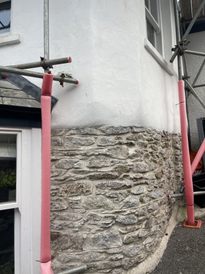

I have a cornish cottage built around 1850 which is mainly built in stone. When I bought it around 80% of the external walls were covered in a 2 inch thick sand and cement render, internally was the same
Initially we removed the concrete render internally and on 3 external walls externally. You could literally see these walls dry before your eyes!
The front external part of the cottage was completely covered in the render and our plan was to remove this also. However we discovered on this part of the cottage (we think originally it was 2) only the ground floor part of the wall is stone and the upper part is block - it possibly had a wooden structure at some point that was replaced? No idea when.
So we removed the render from the ground floor and blended the upper render in. Then pointed up the stone with lime mortar. See photo.
In the upstairs bedroom at this part of the house the inside of the block wall had been skimmed with gypsum. I would like to remove this and use lime plaster straight on the block, as the gypsum plaster has blown in a couple of spots.
My question is this… Is this a good idea?
I know some will say there is no point as there is cement render on outside. However my thought is that any moisture that may get in, can either move down the wall to where there is just stone, or evaporate through the internal lime render??
Does that make sense to anyone? Any help very much appreciated
