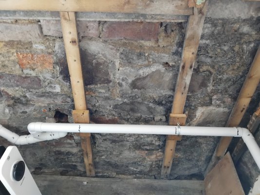

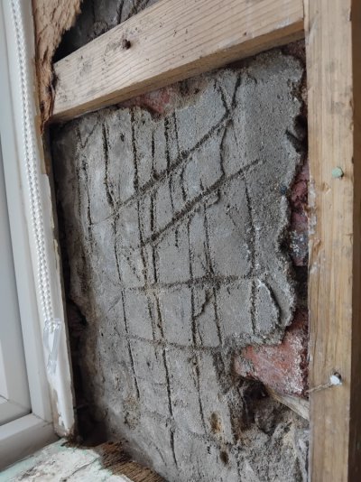

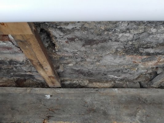

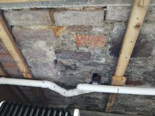

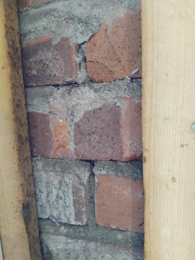

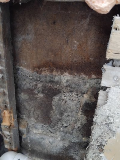

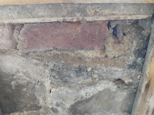

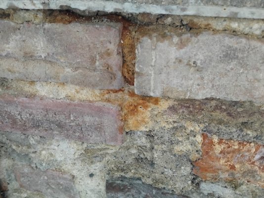

About to start on my smorgasbord kitchen walls
, just wanted to check that I'm doing the right things and not missing anything.
Treat dry rot on the stone
Remove cement/concrete/mortar as much as possible
Scrape out old lime mortar?
Brush, wash, dry out
Repoint (using hot mixed lime mortar)
Replace some of the studs
I'm using fibre cement boards (the lightweight ones) for the walls.
What do I do at the bottom? Are floorboards supposed to go right up to the stone?
Many many thanks
