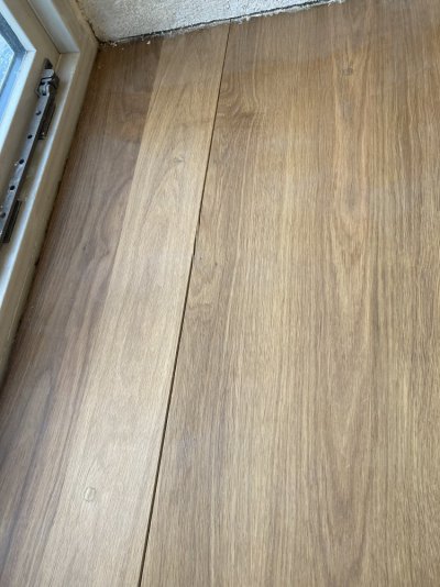

Update: We got 4 reasonably solid, long self-tapping masonry screws down into decent stone, countersunk them, plugged the countersink holes with tapered oak plugs, cut the plugs off flush and then and reoiled. We also fixed the tiny strip of quarter round molding against the window frame to cover the expansion gap. Still need to paint it though.

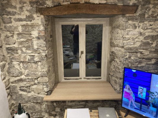

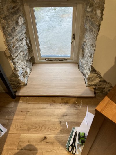

Plus we got our base coats of insulating lime render applied and tied down into the board to cover the scribe lines on both sides of the reveal. It’s ready for us to attempt a proper finishing coat once the existing coats have dried for a couple weeks.
We got some moisture staining around the edges of the board where the moist plaster made contact with the wood. Not sure the best approach for taking those off, hopefully just a mild sanding and re-oiling will do it?
