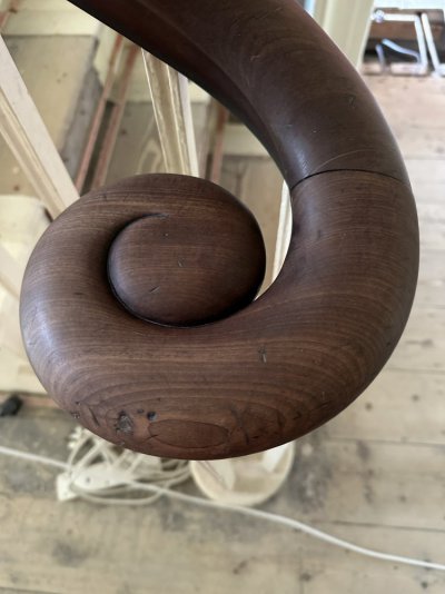

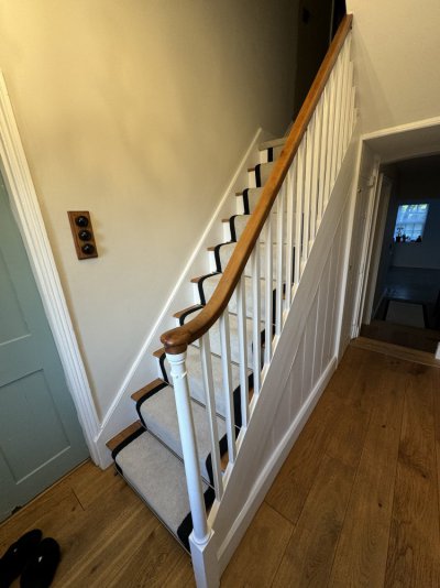

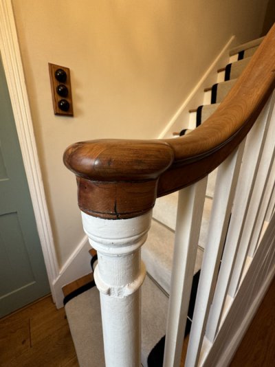

Well, the volute is very nice, but they often choose the sexiest figuring for the monkey tail and / or the first part of the handrail nearest to the newel.
Of course, relatively easy, you will have to carefully sand through the bleaching to get an even colour, it will rebleach again in about 10 to 15 years.Ah okay, thank you. Restorable? (I know it would be by you, I'm asking if us amateurs could...).
Yes, the remainder of the rail is straightforward, but appears the same wood right up to the top floor.Well, the volute is very nice, but they often choose the sexiest figuring for the monkey tail and / or the first part of the handrail nearest to the newel.
Great, thanks Toby. Off to your website I go...Of course, relatively easy, you will have to carefully sand through the bleaching to get an even colour, it will rebleach again in about 10 to 15 years.
Thanks Toby. Last question; am I taking back to bare wood or just trying to take a layer or two of whatever it's been treated with off?If you want a higher sheen then keep coating with more shellac.
Up to you. Looks like wax on bare wood, which was never a traditional finish. If you like the partially bleached, 'flat' look, then leave alone. Even applying a wax remover or new coat of wax could make some of banister go darker. If you want a darker, even, richer finish then you need to strip. There is no 'right' answer. It's the same process for a patinated antique.Thanks Toby. Last question; am I taking back to bare wood or just trying to take a layer or two of whatever it's been treated with off?
Thanks; appreciate the advice.You could strip with boiling hot soapy water or wax remover and 00 wire wool but this is still likely to go patchy. You might want to use maximum no 2 or no 3 grade wire wool when stripping to minimise marks. I would do any sanding by hand.

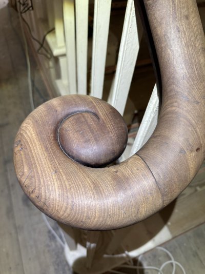

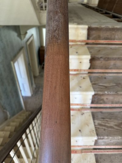

I took a piece of sandpaper to the next flight rail and (eventually) came up with this. Still walnut? There are layers of finish on it.Well, the volute is very nice, but they often choose the sexiest figuring for the monkey tail and / or the first part of the handrail nearest to the newel.
I mean, it could be an amazing bit of teak I suppose but I see no darker figuring, you managed to choose a boring bit devoid of figuring, so well done, seems too dark and too cold for mahogany, just keep stripping more, luckily looks like there is nothing on it apart from wax.I took a piece of sandpaper to the next flight rail and (eventually) came up with this. Still walnut? There are layers of finish on it.
Going to be an epic job stripping four flights!View attachment 13548

Keep us updated, that last photo could be mahogany, but the monkeytail looks like walnut, whatever it is it's going to look very nice.
It's a nice procrastination to have, handrails are always fun to do if they are made of a pretty wood, I mean, apart from the underneath...Thanks Toby. The handrail is one of those 'incidental' jobs that you tackle whilst avoiding the total re-wire, total re-plumb, external rendering, internal plastering, floor repairing/sanding/finishing, window refurbishment etc etc.
The handrail, whilst sectioned all the way up the three stories, does look consistent (albeit manky). I'll try a section on the floor above and we can compare all three exhibits.
