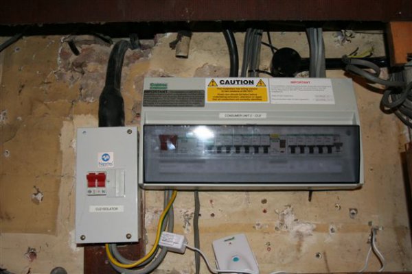

So I nipped off for a day with friends yesterday and came back to this:
It's two foot deep. Just wondering if you think my plan is sound - run the cable from the consumer unit on the other side of the building up through the attics and then out through the music room wall seen on the right side in this photo and to the pond:
Once the pond is pumped filtered and illuminated I'd like to then run another trench from the pond to the gate to have a light there - might that be feasible?
A qualified electrician to do this - if I can find one who is prepared to work in our attics. Many thanks for any input.
