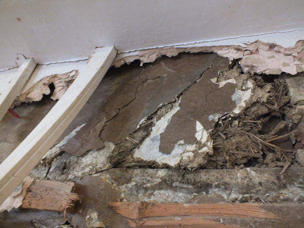

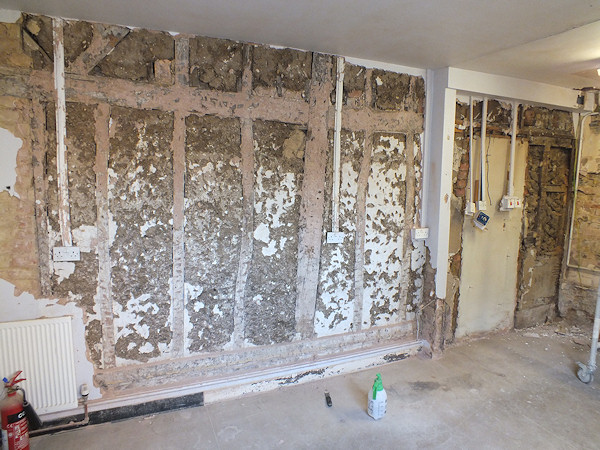

Just for a bit of fun - look what I found behind plasterboard and gypsum plaster in the kitchen. It is part of the original outside wall of my house dating I guess from the late 16th or early 17th century and complete with wattle and daub in good condition. As you might imagine from the photo the room next door has a much lower ceiling height.
I think the kitchen was added on by Georgians. I guess it was them who hacked a door through the timber frame (which is useful as I wanted a door). It looks like they finished the wall with a really thin skim of plaster or just limewash - there is a build up of about 1mm of lime on the beams and wattle and daub which was applied after the door was put in. I don't think any original finishes remain.
I had thought about leaving some of the timber exposed with the daub protected by lime plaster, but the gypsum plaster is proving very difficult to remove from the timber frame and exposed timber might not be practical in a kitchen. I might cover it up again sensitively and have my feature wall somewhere else in the house.
