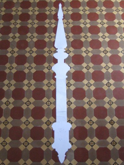

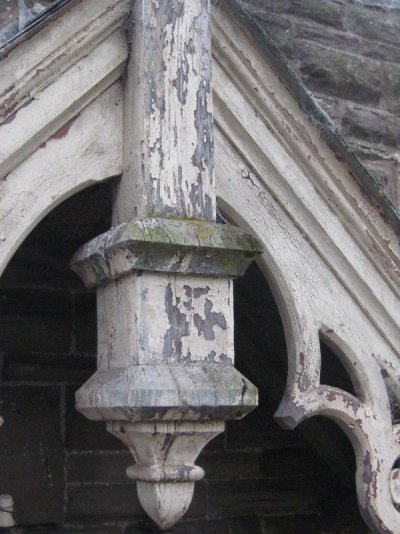

I am new to this forum, but wish I had found it several years ago. I live in a Victorian house in Monmouthshire with rather a lot of finials, most of which need to be replaced due to either their tops having been chopped off or rot. I have taken templates from the originals, which I believe to be pitch pine, and I am trying to source suitable replacements. The four largest ones, which are over seven feet tall (although top 12" was formed seperately) and almost nine inches square, are proving to be difficult to replace. I have contacted a number of joinery companies but none have shown any interest in reproducing them. I presume they will need to be cut using a bandsaw and then finished by hand? I have considerd buying my own bandsaw and doing the job myself to save on cost - it seems that the wood alone is likely to cost about £250 a finial! Has anyone any experience of this type of work or know of a suitable joinery company? I am keen to use pitch pine again but pieces this big would have to be specially imported so I could't see it before I buy - is this timber any good these days, or should I be considering an alternative?
The small finials are much simpler and have a turned base. I have been quoted for making up replacements in sapele by a woodturner. I presume this is a good wood for turning, but would this be a suitable timber for a finial (to be painted with linseed oil paint)?
