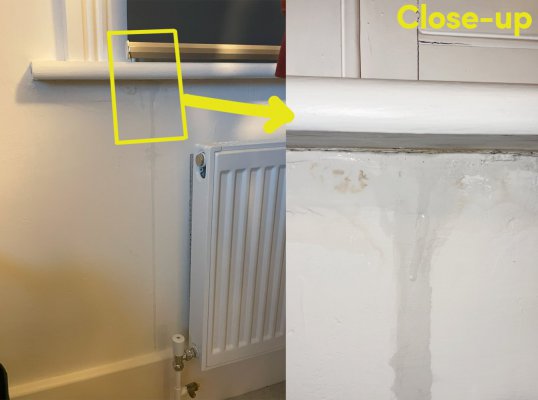

Hi everyone! On Saturday with the easterly winds driving rain into my window, I noticed a leak coming from the sill. The water was coming from under the interior window sill and dripping down my wall.

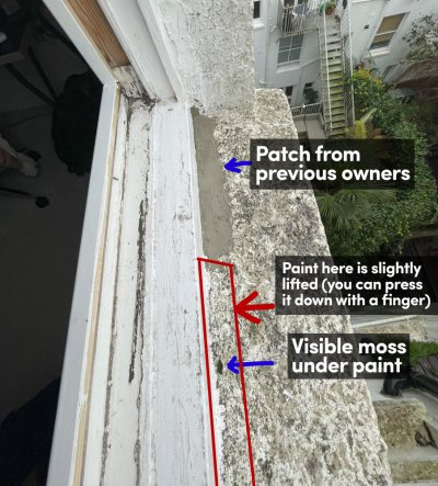

Looking outside (second pic), there is a (cement?) patch that was clearly applied trying to fix this issue. But I guess it has now failed and wind can drive rain through it. As an immediate temporary solution, I dropped a rag over this patch and the leak stopped, so the water really is coming through here.
A similar leak was actually happening on the right side of the window too (not pictured), but that side doesn't have a patch. I did notice there is some give to the paint (marked red area) when pressing it down with the finger, meaning it has lifted. And there is visible moss growing under it in the middle of the window. Dropping another rag over the right side stopped this leak too.
Is this something I can fix myself? I assume I need to scrape away the patch and the paint off the sill outside where it meets the window frame, and apply some sort of sealing and repaint?
