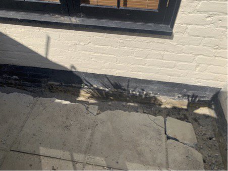

- Excavated a trench around the exterior of the room to below the level of the air bricks. Eventually I will be installing an aco drain at least 150mm below interior floor level and lowering the patio seen in the photo below to be flush with this new drain

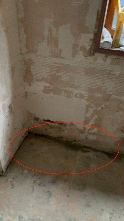

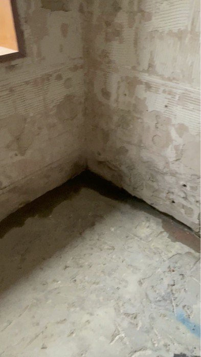

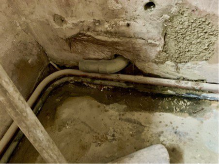

On rerouting the central heating pipes, I found that the slab has no DPM, the middle of the slab however is bone dry. However, the pipes which ran around the room were badly corroded with probable pinhole leaks throughout and a large amount of debris was between and behind the pipework which I have now removed. Below are pictures of before and after the pipes were removed
