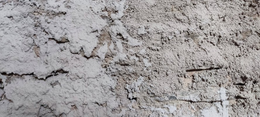

They say a picture is worth a thousand words. To show the difference in finish between Lime Green Stipple Coat (left hand side) and Reabilita Cal CS (right hand side), look at this.
