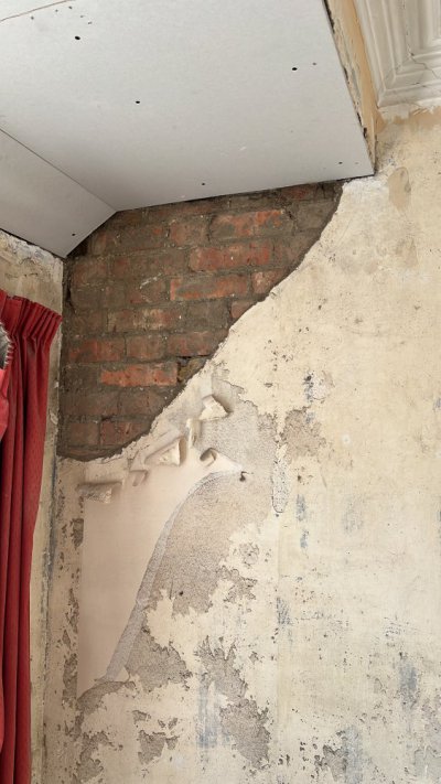

Hi all,
We have some blown lime plaster in the corner of the bay area (bedroom). This was because the bitumen felt above in this corner had collapsed (not sure when) and rain, moisture had penetrated through gradually (through cracks in the lead flashing). Over a long period it time, it seems this is the likely cause of the blown plaster. It had become quite powdery to touch too.
We had this part of the roof repaired (with breathable felt) and new lead flashing - it’s water tight now. We did this about 2 months ago.
As for the like plaster that’s blown, We’ve hacked this area off now - back to brick- and the other parts of the lime plaster seem great and adhered to the wall fine. This wall is also the party wall.
I was originally going to let this area dry for a few good months and then lime plaster it myself. However, my plasterer is saying it’s bone dry and recommends we just apply gypsum plaster it and leave it (so I could potentially move onto decorating the room sooner).
In the future (maybe 5 years or so), I plan to actually go back to brick here. This is mainly because I want to add noise insulation against the party wall. It will be gypsum plastered too since it is not an external wall. I will only wood fibre board and lime plaster my external walls. Having said that, if the condition of the lime plaster seems fine, we may just leave it alone (we’ll see then).
My questions are:
- should I allow it to dry for longer? (it does look and feel dry to touch)
- should I use bonding gypsum plaster and then a skim of gypsum plaster just in this hacked iff area, or the alternative is that I apply lime plaster myself at some point?
My concern is that I want to be in this bedroom soon (it’s the main bedroom), but where it is hacked off, there is quite a bit of dust falling away from the edges of the plaster (which I believe is normal). I don’t want to inhale this nor have it ruin any furniture i may put in here.
Thank you
