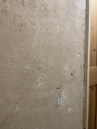

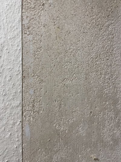

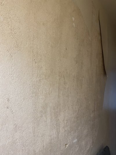

Hello,
Absolute newbie here, hoping to gain a little bit of knowledge!
My partner and I have purchased our first home, an 1880s victorian terrace. Definitely a lot of lessons learned already as the house is riddled with damp issues, years of neglect and poor bodge jobs. Despite all this, we absolutely adore it and are keen to give it some love and get it back to a good condition.
1. We have started stripping back the existing painted wallpapers and the substrate appears to be lime plaster (porous and fairly soft). Most walls so far are not in too bad of a condition with some larger holes to fill in and small indentations where the wallpaper coming off has taken bits of plaster off - photos attached. At its current state we do not think we would need to replaster fully. We have been looking at a product called Patchcote which is lime based and can be used for repairs - has anyone got any experience with something like this? Speaking to the manufacturer they suggested we can apply Patchcote with a trowel over the larger cracks / holes and then just apply a lining paper over (in 2 cross-layers). We would like to redecorate once the walls have been sorted out and worry a little that with a lining paper the lines where the paper meets would be visible and unsightly? Again, any tips or experience shared would be absolutely appreciated. Are there any other clever ways dealing with walls in this condition?
2. In some of the rooms there is an absolute hodge podge of modern fillers and gypsum plasters - again, the areas of lime plaster are in a good condition, however how do we deal with the gypsum / filled areas? Do we have to take it all off and refill / replaster or can we leave it as it, smooth it all out and apply the lining paper over?
