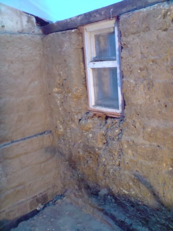

The renovation was performed to a good standard other than, though ignorance I believe, original clay lump walls were wrapped in a concrete render. This will all be coming off soon and replaced by a more appropriate breathable lime render. I've been seeking quotes for the work and costs for removal of the concrete render and replacement with lime render are coming in around £115 + VAT per square metre. There's about 65m2 to replace, with potentially more work required to internal walls and other details. Lime washing of the finished render I will do myself.
